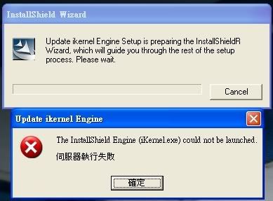

setup failed to launch installation engine
今日想裝個software,點知一double click,load左一陣就彈左句咁ge野。

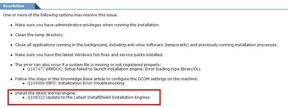

試左幾個方法嫁la,包括delete C:\Program Files\Common Files\InstallShield\engine
之後係e度見到話Update to the Latest InstallShield Installation Engines
http://kb.acresso.com/selfservic ... 105146&sliceId=
之後click左入去佢有一行話[如果我果個setup.exe version number係starts with 6 的話]就download個IkernelUpdate.exe,安裝之前亦需要delete C:\Program Files\Common Files\InstallShield\engine
這個是我想安裝的軟件的exe檔version
download左,delete左,double click 個file version number starts with 6的IkernelUpdate.exe,又load左陣,又彈左句咁ge野
唔知有無c兄知咩事,希望有c兄知點整。另外ge係我windows xp係sp3,我用屋企其他兩部sp2的電腦去裝又可以
