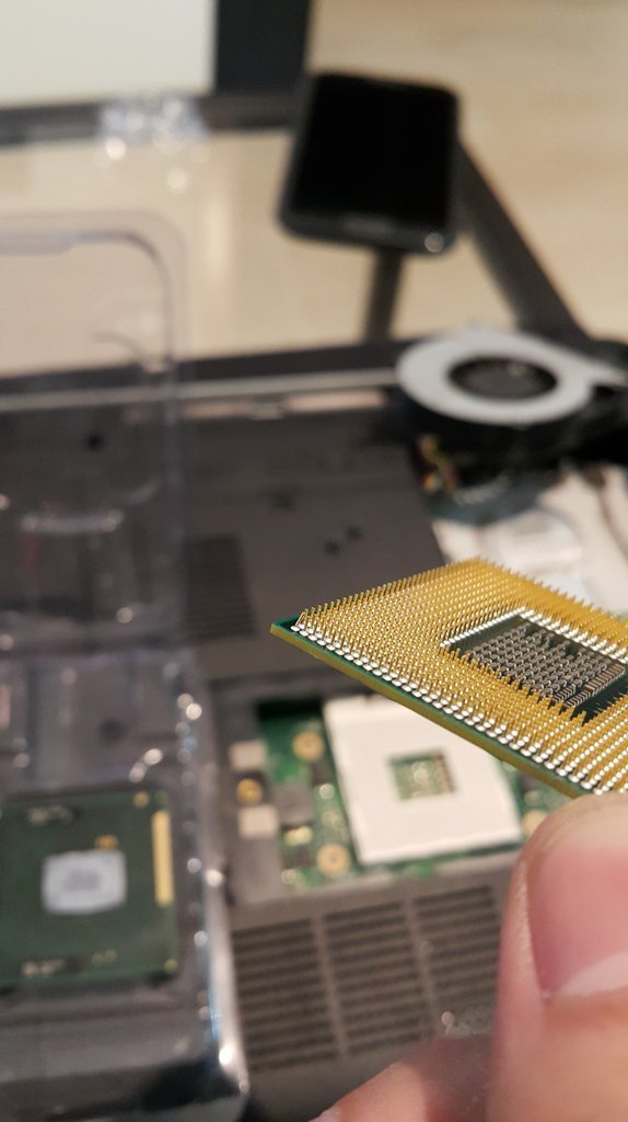

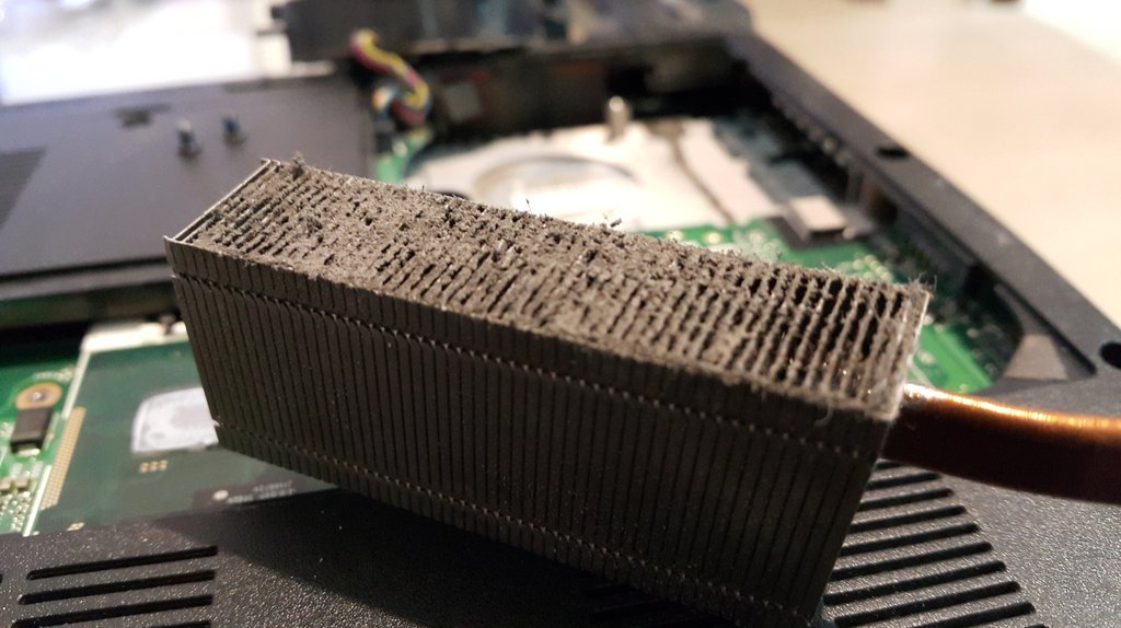

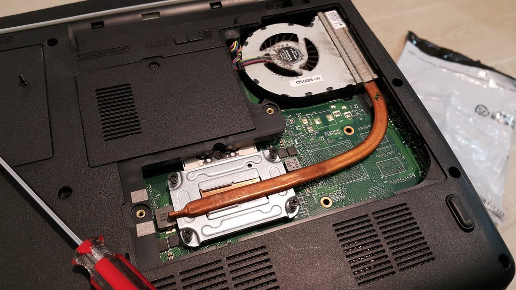

早幾日睇到某個post ( http://www.hkepc.com/forum/viewt ... &extra=page%3D2 ) 既ching講話想部notebook upgrade cpu, 然而睇到另一位ching ( http://www.hkepc.com/forum/viewt ... p;extra=&page=1 ) 個post之前已經upgrade過部同我一樣LH531既cpu, 咁我又見都有成兩年冇清過個heatsink, 咁既然都要拆, 不如tao粒u返黎試下...
過程唔多講喇, 都係拆下抹下...
眼利既師兄/姐應該會發現其中一張相好有問題...lol
我就冇理既, 用#&)買, 真係唔得我都唔肉痛

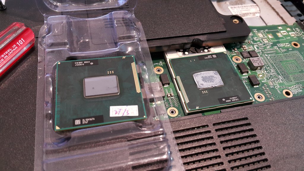

個賣家有同我講話可以買i5 2560m QS chip, 貴20蚊, 其實都有諗過買, 不過d評語話辣辣地, 我都怕會熱得滯, 最後都決定反正版2560m.
我冇update過個bios...一拆即上即power on, 入window睇住佢update driver, reboot後test run兩下, 就一直到而家~

針腳拗左,試下loop benchmark成晚

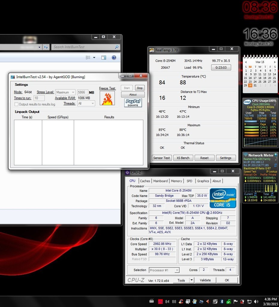

88c a bit too hot. maybe need to reseat the heatsink

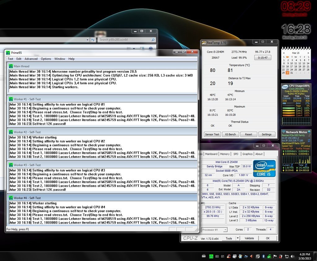

2540m-而家28c室溫, idle 51-55c, 用mx-2, 開頭果幾日未settle都有63c idle....而家睇youtube full screen 先會上60c+.

nah, there isn't much use to reseat a notebook heatsink, it's only going to clamp down as hard as the four spring will push down, besides, 88 isn't that hot, lol, TJmax is still 12 to go, nothing to worry about.
