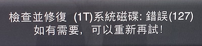

check system disk
LED panel : CHECKING 11 -> ERROR 127
then rebooted by itself

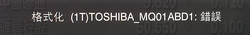

format system disk
LED panel : FORMATTING -> ERROR
Although the system disk cannot be checked and formatted, it's still usable (can save recordings).

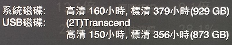

In addition, I've no problem using an external 2TB hdd for recording.

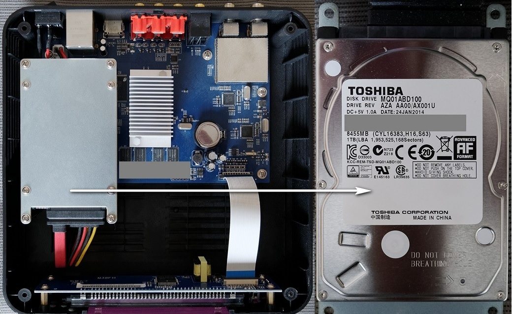

I also don't know about that until recently opened the cover ...
圖片附件: MTV3800D_internal_01.jpg (2016-4-20 17:28, 147.97 KB) / 下載次數 63
https://www.hkepc.com/forum/attachment.php?aid=1883241&k=e443794836b7de223efed0de56bedcfe&t=1782283634&sid=1NGUjcAEK2
