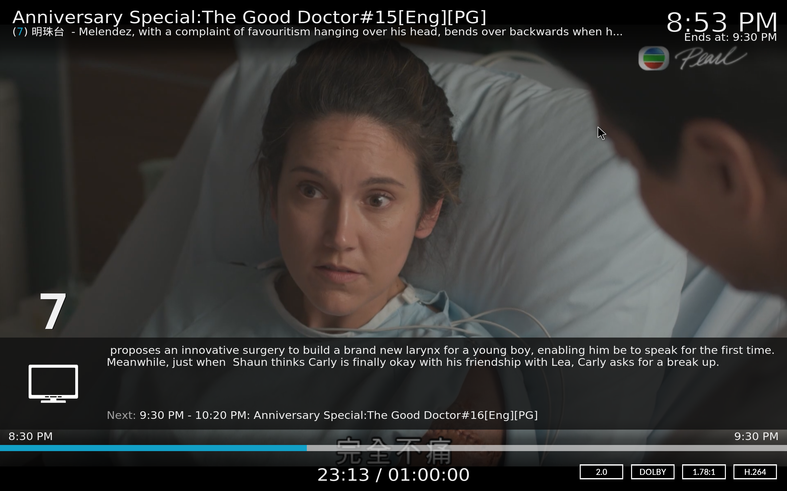

作者: kennylam777    時間: 2020-11-23 20:56
looks good ... anyone tried ?
pandahk 發表於 2020-11-19 20:15
    我啱啱買咗, DTMB同DVB-T2各一
其實都好易set, 店主掃定晒啲台, 係唔同山頭要掃過一次
Clients有幾隻, Windows或者Android TV都建議用Kodi, 揀台/EPG/字幕/聲道乜都齊晒
手提就iOS或者Android都有
https://tvheadend.org/projects/tvheadend/wiki/Clients
