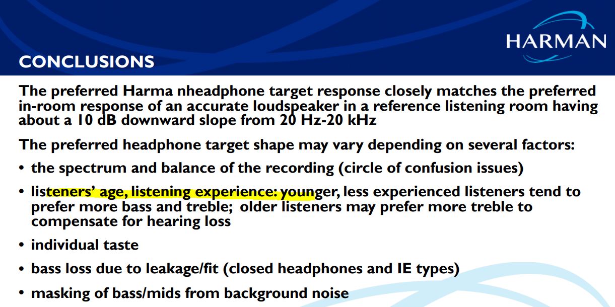

作者: seikomatic    時間: 2021-3-11 10:45
本帖最後由 seikomatic 於 2021-3-11 10:59 編輯
左邊既y軸係聲量(db)、下面x軸係頻率(hz)。
加埋一齊睇就係,邊個頻率hz出到幾大聲db。
呢個圖其實係咁黎 ...
cocteau 發表於 2021-3-10 19:16
".....有某種音染既耳機,聽出黎反而咁先覺得中性..."I think this is the uniqueness of how human brains work....we can always make up missing pieces and filling in gaps ...and even languages might affect the preference across races due to intonation....
IEM manufacturers should tune their products to meet the preference of their target groups of customer by age.
   very educational and clearer now.... then can the effects of separation, staging, spatial effect etc., be measured and shown in some sorts of charts?
