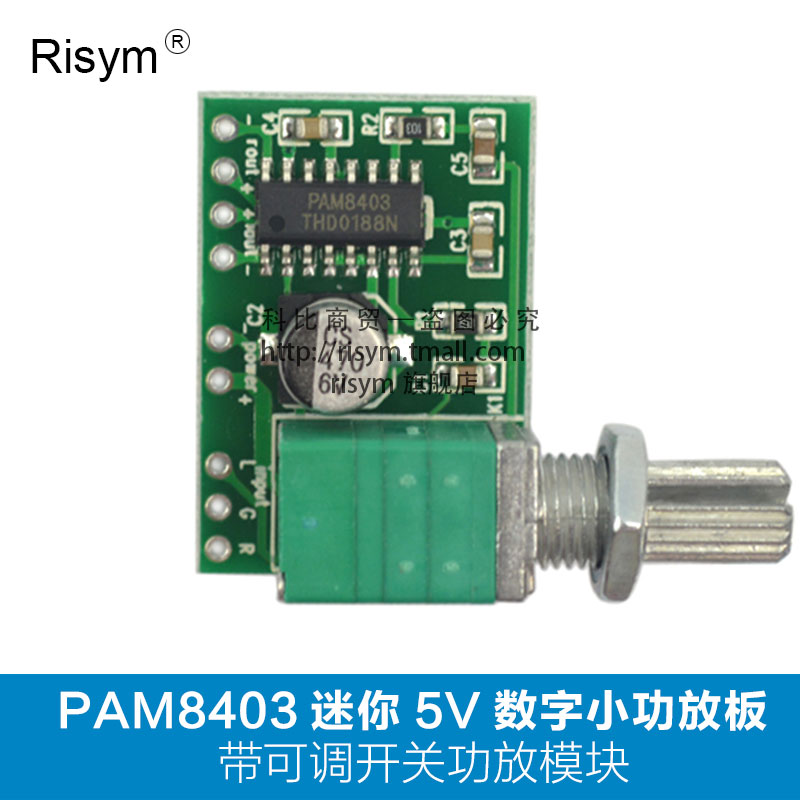

見平平地淘左PAM8403 5V數字功放板, 但開關機時沖激聲好勁下, 有咩方法解決?

作者: diputs    時間: 2017-3-5 19:53
本帖最後由 diputs 於 2017-3-5 20:16 編輯
PAM8403有一隻Mute腳 (Pin5),可試試將果隻腳(接PVDD)甩開原來5V,再經電阻電容(或單接電容,利用IC內部的上拉電阻)調延遲時間配合聽唔到POP聲。
The MUTE pin  is  an  input  for  controlling  the output state of the PAM8403. A logic low on this pin disables the outputs, and a logic high on this pin enables the outputs. This pin may be used as a quick disable or enable of the outputs without a volume  fade.  Quiescent  current  is  listed  in  the electrical characteristic table. The pin can be left floating due to the internal pull-up.
When VDD=5V, Vmute=0.3V, I mute is approx. 3.5mA
