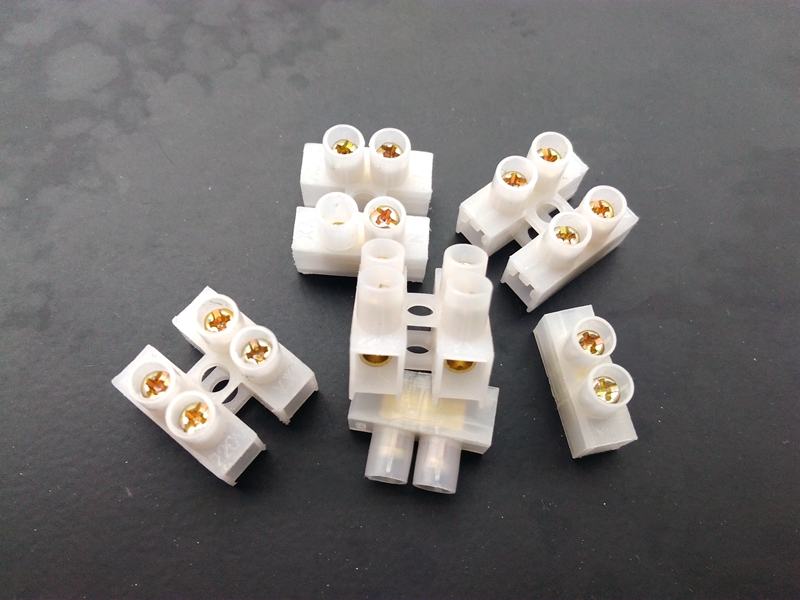

買依隻啦!用緊係部掛燙機到,幾實!又無發熱!
https://detail.tmall.com/item.htm?id=533660825502
[attach]2116077[/attach]

[attach]2116535[/attach]
見過鴨記五金鋪有得賣
