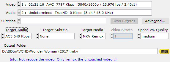

我是MKV轉到MKV的,但Target選"MKV Remux"時 APP顯示" Info: Not recode the video. Only remux the untouched video :),之後Start Jobs ==> Failed
圖片附件: unCode.png (2018-2-8 17:23, 12.63 KB) / 下載次數 21

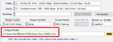

Incorrect file name
correct
圖片附件: incorrect.png (2018-2-8 18:48, 12.74 KB) / 下載次數 19
https://www.hkepc.com/forum/attachment.php?aid=2040898&k=630459551298ccf6de01d957910503b2&t=1781536565&sid=3sOUveU07J
圖片附件: correct.png (2018-2-8 18:49, 54.09 KB) / 下載次數 17
https://www.hkepc.com/forum/attachment.php?aid=2040899&k=43f645b48d366550aec8ac7999da5d70&t=1781536565&sid=3sOUveU07J

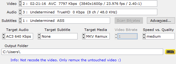

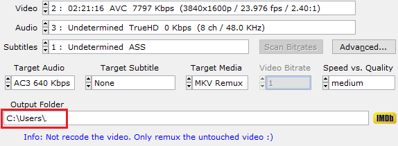

你的圖也顯示藍色文字Not recode the video. Only remux the untouched video :),你可完成轉碼嗎?我便不成功了?
按"Add to Queue" 及"Start Jobs":
圖片附件: 1st.png (2018-2-8 19:43, 12.92 KB) / 下載次數 15
https://www.hkepc.com/forum/attachment.php?aid=2040900&k=b93dba9655c52dddcabb0f62d79aa6ef&t=1781536565&sid=3sOUveU07J
圖片附件: 2nd.png (2018-2-8 19:44, 5.18 KB) / 下載次數 16
https://www.hkepc.com/forum/attachment.php?aid=2040901&k=f813a9fa65e03eb6307f2e9d1aec1a8d&t=1781536565&sid=3sOUveU07J

click options->setting find temp folder location
use MKVToolNix GUI
https://www.videohelp.com/software/MKVToolNix
將*.h264/*.h265 +*.ac3 remix 做mkv 未命名.png
圖片附件: 未命名.png (2018-2-8 20:43, 76.43 KB) / 下載次數 19
https://www.hkepc.com/forum/attachment.php?aid=2040910&k=e386bf8a4f91a7641b9cf8a54b1a84ce&t=1781536565&sid=3sOUveU07J
