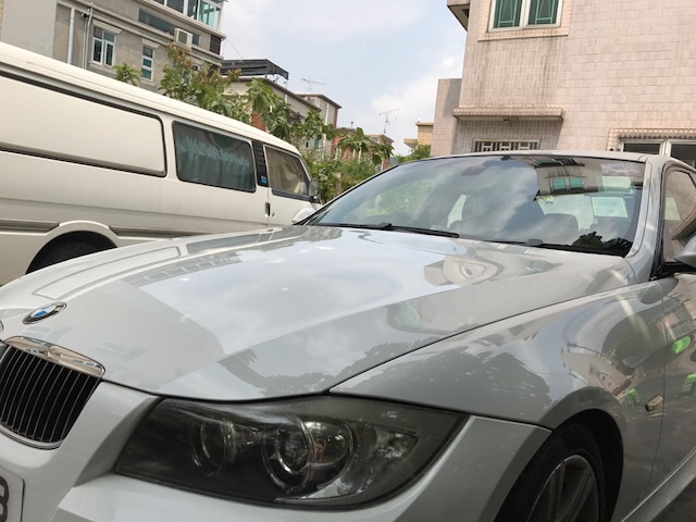

Update 2014-12-27/28:
Took my car out for a spin.  It was drizzling so when I arrived at the car it was covered in tiny beads on roof:
Windscreen and engine hood:
After a short drive in local area, the side windows almost completely dried:
Trunk with a few droplets left:
The right windows was wet because I opened the windows for using my parking lot access card.
Wipers has no jumping.  They just glide over the glass smoothly.  Engine hood did well too.
We all know that drizzles are too small to bead up and fly away.
WG DGLS is a very hydrophobic LSP and I am happy with it.
Update 2015-02-15:
I have not washed the car for ~3 months.  It was covered in dust.
Rain water is beading up on paint:
Also on windows.  See the water flying down?
A 10 minutes drive back home give me a clean, 99% dry car:
This is all the water left behind on my quarter panel, side windows and door.
Paint is slick and gloss is there.
The self-cleaning is amazing.

Update 2015-06-14:
No wash, no wax, no toppings for a few months, but the car still looking good to my eyes.
The self-cleaning performance of DGLS is very good.

Update 2015-06-27:
I drove 100km yesterday to work.
No wash no wax, if there is rainwater get on my car, no drying is done.
This is how my car looked from the back.
Not much visible dust is gathering on my car because it is slick and anti-static.
The front end taken by Samsung phone - Samsung white balance and exposure totally rubbish.
The car is still reasonably clean.

Final update 2016-10-10:
Car was last sealed with DGLS for over half year.
Several washings had been done.
Today I sprayed my dusty car down with softened water.
Supposed to have very low surface tension, but still beaded and sheeted quickly.
[youtube]tSyGeruB_uE[/youtube]
https://www.youtube.com/watch?v=tSyGeruB_uE
WG DGLS is the man!
WG DGLS has proven to be an excellent product with intense protection for solid 8 months.
Judging from the water beading, slickness and gloss, I am confident it can be stretched to 12 months!

作者: TTLL1819    時間: 2018-3-29 18:20
TTLL1819,
Thank you very much for your post.
I have done a wide range of BMWs before.
Alpine whi ...
PPLd 發表於 2018-3-9 10:42
Finally have time to refresh my old car following PPLd suggestions.
Though it's not prefect. I'm very happy about it
圖片附件: IMG_1340.JPG (2018-3-29 18:16, 96.83 KB) / 下載次數 219
https://www.hkepc.com/forum/attachment.php?aid=2049473&k=c026e773506701253ec53b4b2a1c9eb0&t=1781482371&sid=18qYITsjcM
作者: PPLd    時間: 2018-3-29 20:17
Though it's not prefect. I'm  ...
TTLL1819 發表於 2018-3-29 18:20
Hi,
It seems your car is very glossy, even in white.
I am glad you found my free suggestions useful!
