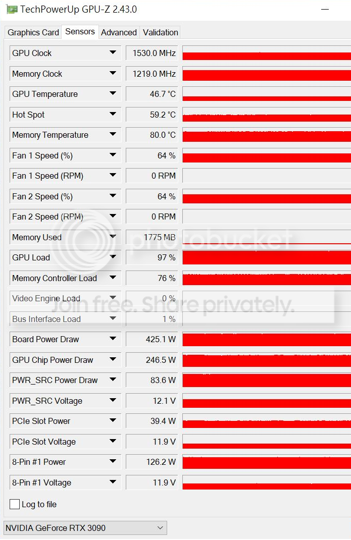

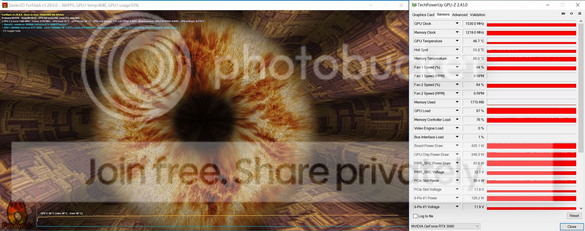

For reference, Giga 3090 AIO watercooling
88% power limt, only change back ram with 3mm sticker + 9cm 1200rpm cooling fan > back plate
Furmark 5120x2160 8xaa sampling - 5mins (Room temp 27'c)
GPU 60'c & boost at 18xx
Hot spot 7x-80'c
Ram 7x-80'x
