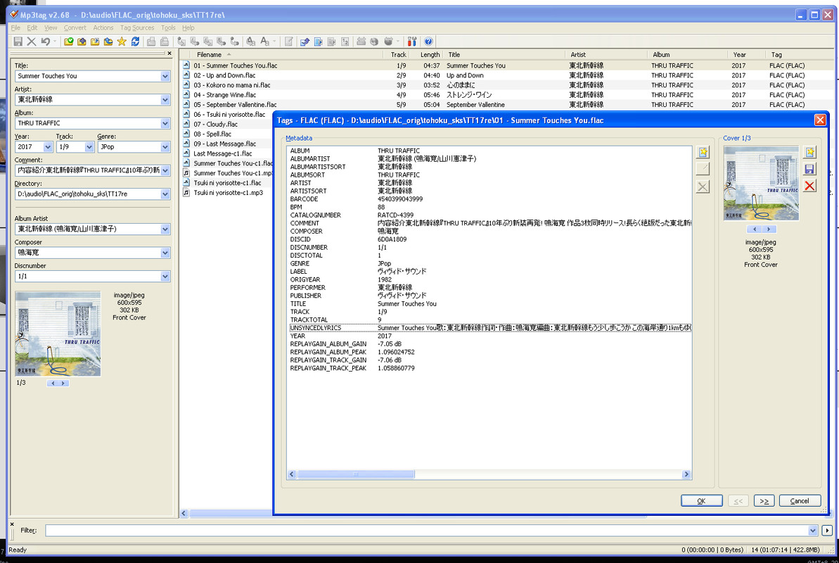

作者: anon893    時間: 2019-7-15 18:33
本帖最後由 anon893 於 2019-7-15 18:35 編輯
同問, 如果直轉ISO會唔會好o的?
a2462 發表於 2019-7-15 05:25 PM
If you need mass duplication then maybe...
Otherwise, no point
Also you want to manage the music tracks preferably as individual files
If you do a single file rip complete with cuesheet your options for effective metadata tagging will be very limited
作者: harryytm    時間: 2019-7-15 20:09

dd to raw image
作者: anon893    時間: 2019-7-16 15:05
I don't see your point valid, please illustrate.
harryytm 發表於 2019-7-15 08:09 PM
Simply put, you can't tag a single disc image as detailed as an individual track... period

作者: harryytm    時間: 2019-7-16 19:13
本帖最後由 harryytm 於 2019-7-16 19:22 編輯
anon893 發表於 2019-7-16 15:05
No, Foobar2000 can do that.
You don't know how to properly use a tool doesn't mean that tool can't do that.
[attach]2138285[/attach]

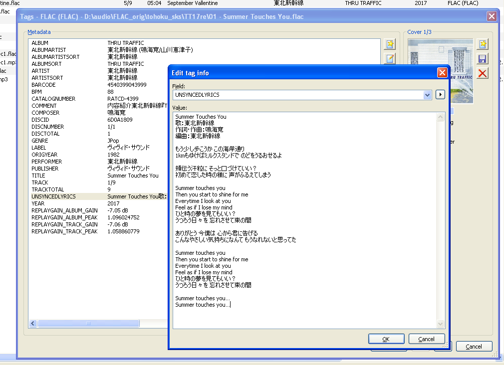

作者: anon893    時間: 2019-7-17 16:18
You don't know how to properly use a tool doesn't mean that tool can' ...
harryytm 發表於 2019-7-16 07:13 PM
Watch your mouth... (you are getting cocky)
You call this full tagging capabilities?
Been there, done that... simply don't like it, not intuitive enough

個flac加相加歌詞, 可以點搞??
加相我都係用番tag n rename加入去.歌詞點搞?仲有cue ...
正宗球迷 發表於 2019-7-6 00:48
Foobar2000 加相嘅話,首先選取曬全部你想加相嘅歌,然後右按選擇 Tagging -> Front Cover
[attach]2138509[/attach]
而歌詞嘅話 Foobar2000 本身唔支援,但有插件可以做到,而且仲有個好方便嘅介面,可以簡單自行製作同步歌詞,有時仲會自動搵埋同步歌詞。
https://www.foobar2000.org/components/view/foo_uie_lyrics3
[attach]2138520[/attach]
^ 播放時顯示同步歌詞
[attach]2138519[/attach]
^ 製作同步歌詞介面
