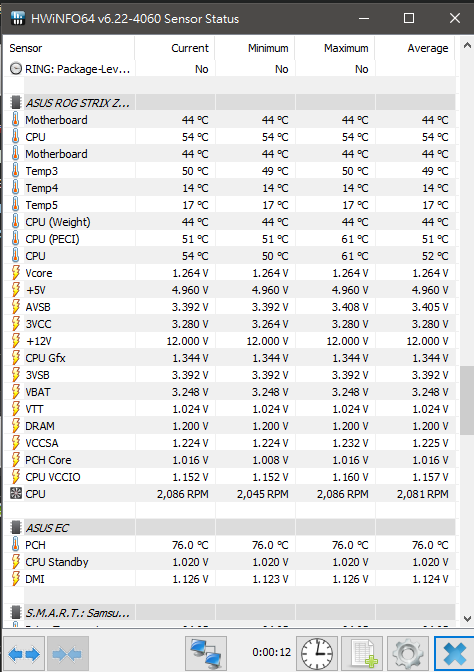

作者: xrayhk2017    時間: 2020-2-13 21:17
回覆 11# 風風
Idunn know which one is vrm tem tho
圖片附件: 螢幕擷取畫面 (61).png (2020-2-13 21:16, 48.14 KB) / 下載次數 261
https://www.hkepc.com/forum/attachment.php?aid=2175946&k=c89a5a9c7a0b4d41b4574fdf504aa100&t=1781460806&sid=67PEhol9Lx

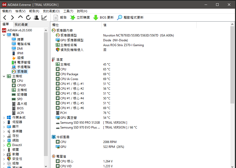

作者: xrayhk2017    時間: 2020-2-13 21:55
塊底板係咪有問題VRM溫度check唔到
圖片附件: 螢幕擷取畫面 (63).png (2020-2-13 21:54, 86.05 KB) / 下載次數 168
https://www.hkepc.com/forum/attachment.php?aid=2175951&k=63e9e53b6904daadb831ce74acc39d94&t=1781460806&sid=67PEhol9Lx

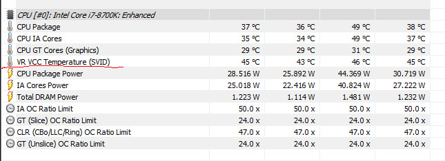

作者: 風風    時間: 2020-2-13 22:04
Here, you may need to run the CPU a bit to see it in HWINFO64
圖片附件: vrm.jpg (2020-2-13 22:03, 80.18 KB) / 下載次數 199
https://www.hkepc.com/forum/attachment.php?aid=2175953&k=df37fec86c75bfed4a71491d64cad1bc&t=1781460806&sid=67PEhol9Lx
