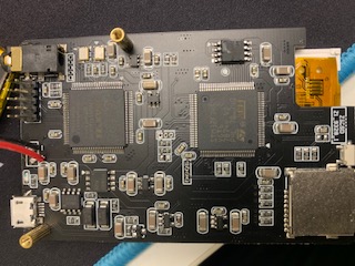

Just Received it on Sunday , outlook as same as 749 version . Let's take apart it directly .

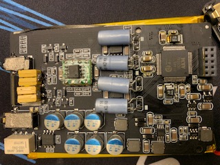

12v as standard for this version
opamp for 3.5mm become dual OPA627AU now
for Balanced 2.5mm , opamp will be pair of AD8620

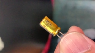

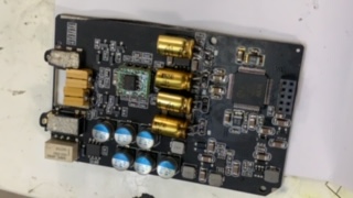

In my personal view , the Philips caps ( 100uF / 10v ) make me feel a bit upset . My friend's 749 RMB version comes with Nichicon FW caps ( 100uF / 16v ) ... so I got some tricky things during my lunch time
Audio Note 快晴電解電容 ( 100uF /16v )
2019-12-3 14:44
And then find a shop solder it for me , the solder for these 4 caps also from Audio Note ( with 6 % silver )

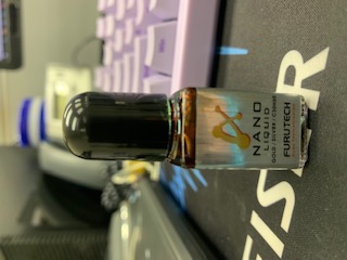

There are 10 pins for connecting 2 boards at this player , all 10 pins feed with Furutech Nano Liquid

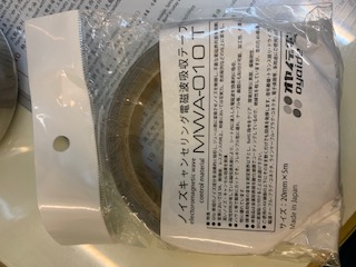

For the micro SD Card Reader , 2.5mm plug , 3.5mm plug , the micro USB port , shielded by Oyaide MWA-010T tape

出來的效果非常滿意,層次感有提昇,女聲比起我搞事前多左一份貴氣及亮麗感

AD8620 is good stuff. FET low input impedance is good for DAC output LPF.
OPA627 may be too old in terms of design and ratings. Newer opamp may be better (line driver, buffer).
An interesting thing is the capacitors. Photo shows that LPF output capacitors are e-cap and line output capacitors are ceramic cap. I think the selection should be reversed. LPF uses ceramic cap (small signal, more accurate) and line output uses e-cap (large signal, more musical).
OPA627 may be too old in  ...
pallee 發表於 2019-12-4 23:35
Does it means that I should keep the ceramic cap and just re-solder it by own Audio note solder ?
