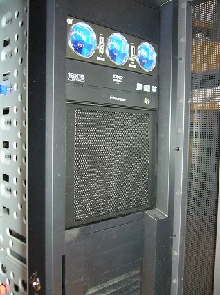

looks like you do not have enough air intake to cool the system
try this 12cm bay cooling from scythe, comes with easily removable dust filter
you can change the fan to a higher speed model if you need even more air flow
Lian Li and Silverstone have similar products, you can find silverstone in Capital computer
個隔塵網是在邊個位?
面板就是隔塵網?
原帖由 s200010098 於 2009-4-10 21:31 發表
個隔塵網是在邊個位?
面板就是隔塵網?
you can see there is a filter inside, in between the panel and the 12cm fan, thats the dust filter
