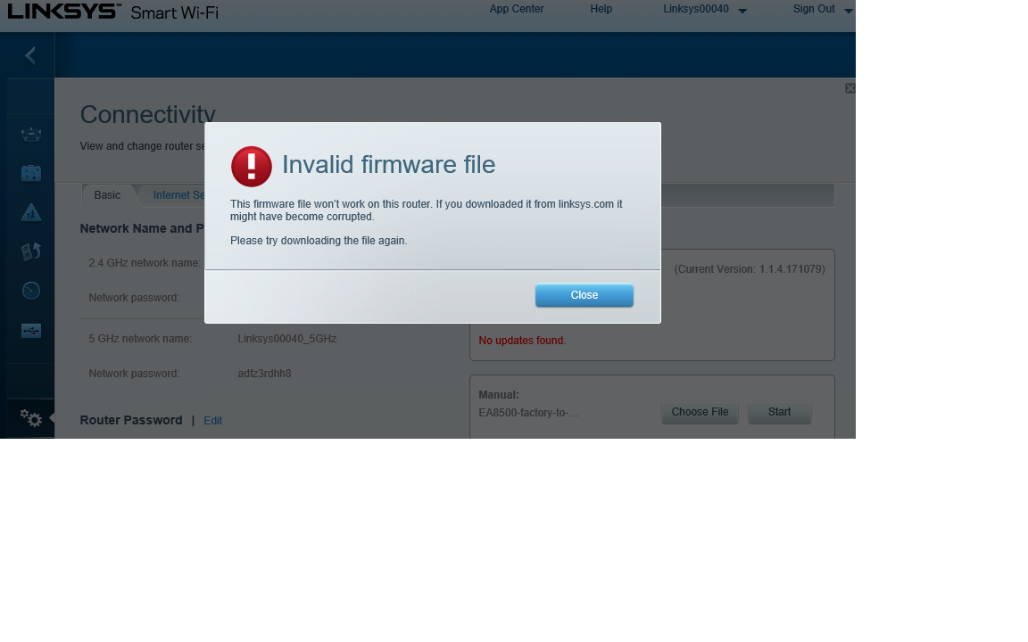

Just buy EA-8500 Router from SPP, can not update the "EA8500-factory-to-ddwrt.img", the following error message appears, any ideas?

回覆 99# kevinkwan1997
    請問個model no.係咪EA8500-AH 或EA8500-HK? 如果係既試下再DOWNLOAD過黎試, 都係唔得既, 我見你係最新既1.1.4-171079, 又或者試下RESTORE去舊少少既FIRMWARE再試過. 我用1.1.4-16XXXX既FIRMWARE可以FLASH到. 但1.1.4-17XXXX就未試過.
