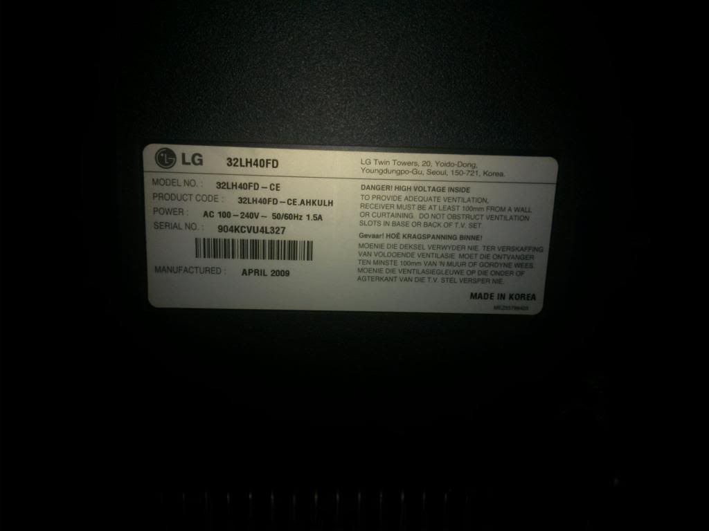

外表90% 新 LG 32寸LCD IDTV 32LH40FD, 有聲無畫 10/5
本帖最後由 harry1988 於 2013-5-5 20:03 編輯
剛好三年幾機, 壞左, 有凶宅購買單據過保

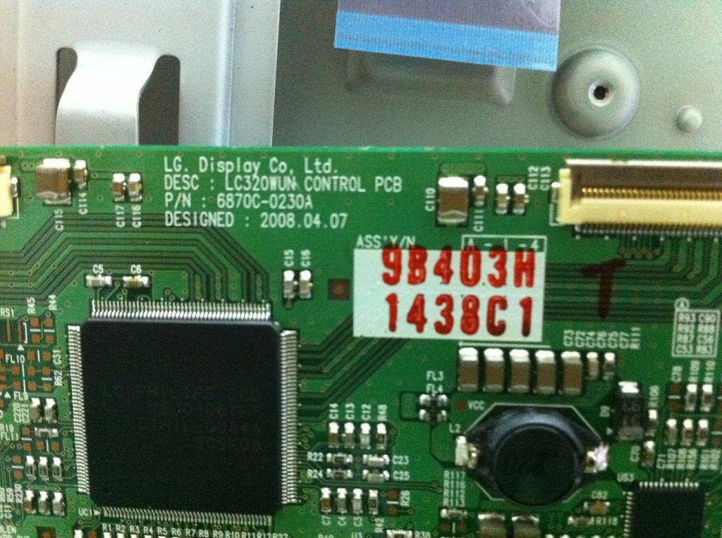

曾經叫過上邊既師傅黎睇, 收左300$ 檢查費, 話要換800$ 其中一塊板
因為太貴, 無換

當時維修師傅係話要換以下呢塊, 我即場影左相

c-hing, why don't try this http://s.taobao.com/search?q=687 ... e_id=itemz_20130506
it is not expensive. u can see ur tv aft. replace this.
真定假?佢同我講要800
try it, plug n play, i tried similar case. it really works

harry1988 發表於 2013-5-6 09:43
原廠要食你人工舖租,幾十一百淘落黎玩下都OK~
何況你都睇哂師父成個過程,換佢唔難丫

800 can buy 10 pcs at tb, u can 2 pcs first, 1 for replacement + 1 for spare.
