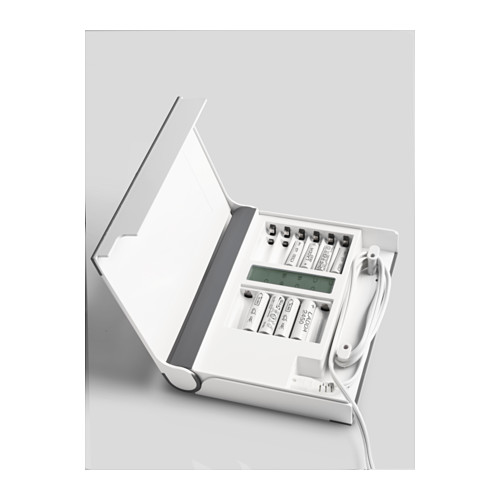

今日經過 IKEA 買咗 2包充電,AA $69.9, AAA$49.9
2016-7-31 21:26

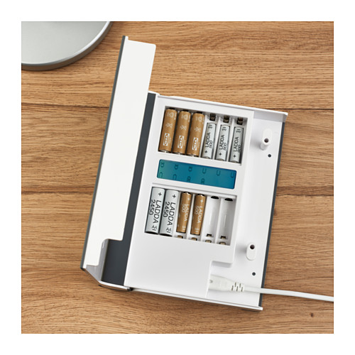

上次介紹過 3 ports USB充電器,今次見到呢隻充電器可以向大家介紹下,
一隻可以同時充 12粒 Ni-MH 電池的充電器,$299. 而且係12個獨立充電管理,
呢個充電器有 LCD 顯示充電狀態,充滿電檢測方式採用 (-dV/dT or 0dV/dT)
好似都唔錯。
Model: TYP E1520
Storhögen
Input: 100-240V, 0.3A
Output: AA 12 x 1.4V, 0.25A
AAA 12 x 1.4V, 0.11A
Recommended battery types:
NiMH AA max 2450mAh, AAA max 900mAh,
Charger features
— Charge and store 1 to 12 pieces of HR6/
AA and/or 1 to 12 pieces of HR03/AAA
rechargeable batteries.
— 12 charging channels.
— Charge is terminated by individual
minus delta or zero delta voltage
sensors (-dV/dT or 0dV/dT) .
— Safety by separate safety timer and
temperature sensor.
— After fully charged batteries, charger
will go into trickle charging, enables
batteries to be stored in the charger.
— Non-rechargeable and damaged
batteries detection.
— Charging status LCD display.
— Possible to wall mount

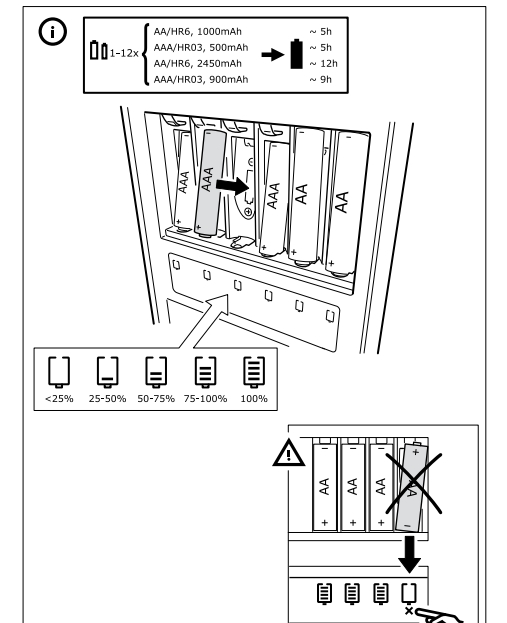

有無 CHing 已經買咗用緊呀!
12hr充一粒2450mAh
雖然價錢真係吸引
不過2450咁大, 唔似係低放電喎
本帖最後由 william-yeung 於 2016-7-31 22:06 編輯
回覆 2# KinChungE
    正常用0.1C 來 充 2450mAh.  12hrs 充滿好正常,標準 0.1C充電,粒電長壽好多,而見呢個充電器唔可以 set 快充呵。
或者可以咁講,12 hrs 充 12粒 2450mAh電,都好快吖!

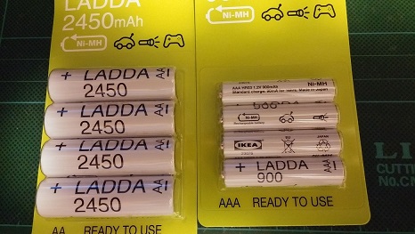

    呢隻 LADDA 電池 係 MIJ, 有網站測試過,性能似 sanyo, fujitsu 電池,有Ching 都用過,
見到 CHing 用過無乜投訴,所以買 2包看下門口,呢個價錢買 MIJ 電池,算抵用,
而家我用緊隻SkyRC NC2500  Refresh 4粒電試緊,要跑一日。
講真LADDA MIJ AA 2450 $69.9 唔平, 又冇講係咪低自放.
我在日本買eneloop pro 2450 x 8粒 MIJ 都係 HKD150.

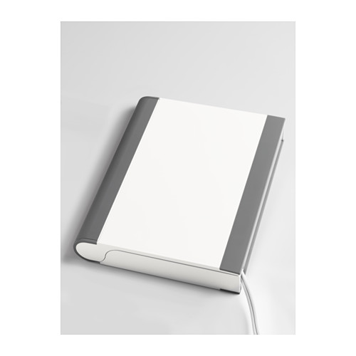

佢supppose你開蓋屮定冚蓋屮?
冚蓋又熱又睇唔到顯示屏,開蓋又易碰到
