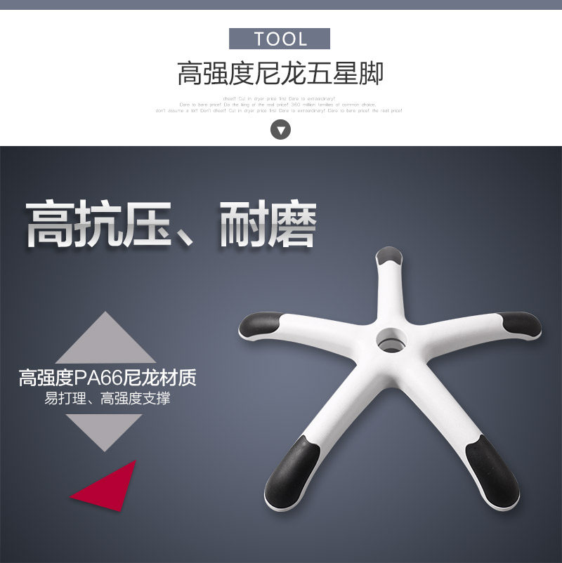

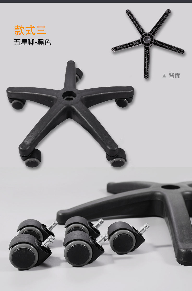

買返隻腳換就得 只係幾兜野
https://item.taobao.com/item.htm ... 106&ns=1#detail
