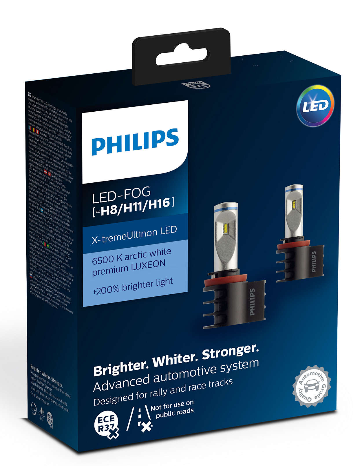

Product description (adapted from Philips):
The new X-treme Ultinon LED headlights range is the culmination of years of technological innovation, utilising a variety of Philips’ patented design features in order to achieve a headlight that surpasses expectations in every field. With the help of LUXEON LED technology, the bulbs achieve a bright white light with a colour temperature of 6500K, producing a 200% brighter light than that of a standard halogen.
What’s more, the stylish white light effect of the X-treme Ultinon LED headlights' beam is designed with precision in mind, making use of SafeBeam technology to ensure that the bulbs’ extra light stays where it belongs: on the road. As well as being more distinctive than a standard halogen light, the white LED light produced is closer to the colour of natural daylight, helping you to stay alert and energised on the road at night. The refined positioning of the strong, uniform LED light enables you to see far-away obstacles on the road, without the risk of dazzling other drivers.
The expert craft of the X-treme Ultinon LED headlights range also means that you can enjoy the benefits of a brighter, whiter light for longer. Philips have implemented advanced AirFlux and AirCool technologies to increase the bulbs’ heat resistance, diverting heat from any critical components, thus extending their lifetime. These intelligent heat management systems, combined with the higher light intensity level of the LED, make for an impressively durable bulb with a remarkably long life of up to 12 years.
With the X-treme Ultinon LED headlights' easy installation process you can enjoy extra sight, style, safety and bulb-life in no time at all. Get ready to outshine and out-style the competition.
Technology LED
Mount H8, H11, H16
Protection IP65
Electrical Data
Wattage 10.0 W
Voltage 12.0 V
Photometrical data
Color temperature 2700 K or 6500 K
Luminous flux 1200 lm
Lifespan Up to 12 years
Image credit: Philips

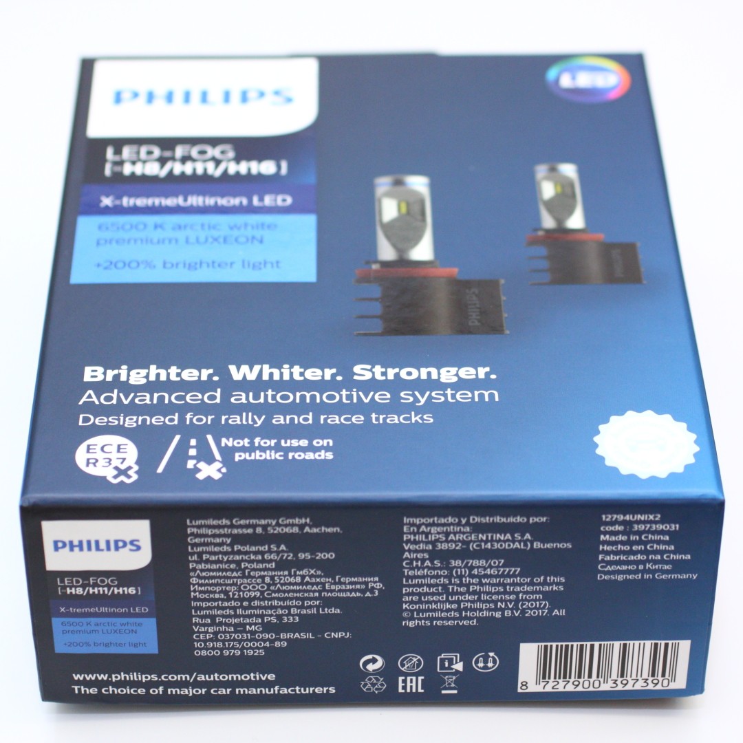

The packaging design of the Philips LED bulb.
Remember, they are my off road accessory.
